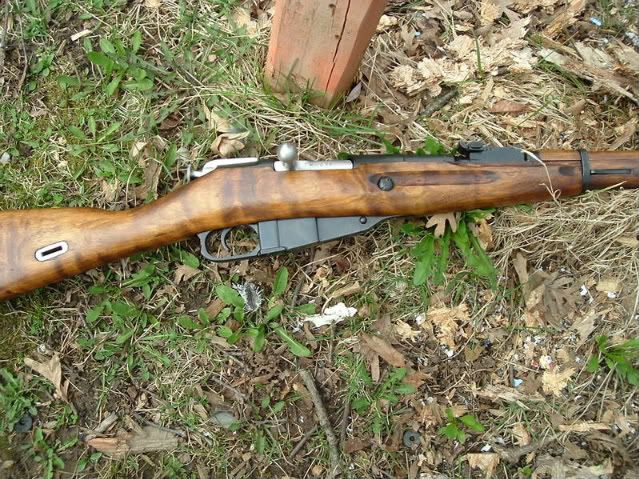

After much experimentation and to the chargine of my collector buddies(sic), I have come to the conclusion that a good scubbing of the stock (of course without the iron) with hot water and Murphy's Oil Soap, followed (after drying) with using a stain/varnish biodegradeable gel (wipe on-wipe off, 0000 steel wool optional), washing off remaining residue with MS (mineral spirits), let it dry, steel wool it smooth, stain to taste or like I do...use BLO (boiled linseed oil) steel wooling between the four to five coats, then finish up with a good coat of gun wax (carnuba with bee wax).
Hopefully it turns out like this:
and the '73 Win here;

Nice looking Mosin!
