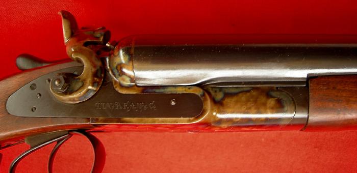

Leveraction frames will warp if not done right.The first CC-ed Rossi's (late 90's) were real bears to make work right. Mike and turnbull are the only folks I trust to do it and not warp them.
Mike's currently doing the TTN SXS's for my CAS customers.

Re: Caution on who does Color Case hardening
Absolutely gorgeous. I can foresee doing a calendar featuring a different CCH'd firearm for each month.

Steve; they look good assembled, still think the side plates on those SxS need to be CCH’d though.
