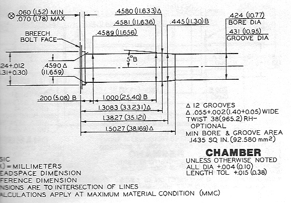

My refernce material is limited ... but here are the SAAMI specs I have:
44 Magnum rifle: (microgroove barrel)
44 Magnum pistol:
Bore diameter is slightly larger on the rifle and the depth of the grooves on the rifle is shallower than the handgun.
