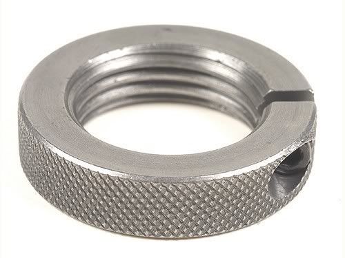

I see that Lyman sells replacement nuts, split ring and regular, for $2.50 each.
So, what are split rings?
Re: Lyman Dies
Lyman's split ring:

It seems like the little rubber "Lee" ones would be fine if the dies are left installed in a removable plate (i.e. Dillon) or turret (i.e. Lee), and you size them all the same, but if you're using a single stage press you'd sure want the locking rings, and if you're using a single stage press AND several adjustments for different specs, you'd want the 'split' locking rings just so you could easily adjust and re-lock them without too much wear and tear.
Perhaps someone really clever could come up with an indexing system to scribe on the locking ring and the die so you could go back to your 'other' sizing setting, etc...
