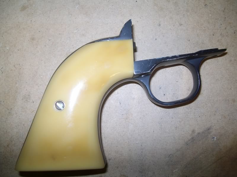

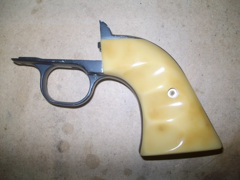

I recently bought an XR3 grip frame for my Rugers from a seller on TRF. These John Wayne type grips came on the frame. I was told they are some sort of polymer.
What I'm curious about is what they are made of. It's not just run of the mill plastic. They are solid, cut from a solid chunk rather than molded, and the mottled color goes all they way through.
They also have a definite pungent odor. It's a cross between vanilla, and moth balls. I've never smelled any form of plastic that smelled like this.
Does anybody here have any ideas what they might be made of?

Micarta maybe?
Re: OT: Need grip material ID help
I'm pretty sure they aren't micarta. There's no layers.

Their grips use phenolic resin ( which has an odor like you described ) as the binder for the Micarta.. the grips made with paper laminations wont show then laminations like the ones made with linen or canvas laminations, which could explain why you don't see laminations in yours.. dunno .. just a guess
WIL TERRY
Ben,
You might be right about the phenolic resin. However I still don't think they are micarta. I used a 15 power loop with a strong light and there is no layers, small or large. Also the light shines through like an opaque rather than a laminated solid. Also there is very tiny bubbles in the material, so it must be a casting.

If they are a solid material without layers, I think it is probably Corian. It is a man made material that is used for counter tops and shower stalls because the color goes all the way through. It is really good for things like handgun grips because if it is burned, scratched or chipped you can sand it and still have color.
Check out Collins Craft grips at www.collinscraftgrips.com .
They could also be Buffalo Brothers grips at www.buffalobrothers.net
The finger notches look like one they do that is supposed to be a John Wayne style.
Meeteetse wrote:If they are a solid material without layers, I think it is probably Corian. It is a man made material that is used for counter tops and shower stalls because the color goes all the way through. It is really good for things like handgun grips because if it is burned, scratched or chipped you can sand it and still have color.
Check out Collins Craft grips at http://www.collinscraftgrips.com .
They could also be Buffalo Brothers grips at http://www.buffalobrothers.net
Meeteetse,
I think you found them. The set I have is identical to the shape and visual appearance of the ones in the Buffalo Brothers grip site. I could even see the tiny surface bubbles in their photo.
Their web site says the grips are made from polyurethane. I wonder if that stuff has this kind of smell?

Did you try looking at the inside of the countersunk hole where the threaded portion of the grip screw is? That looks like a surface that is cut but not polished. You might be able to tell more with your loop by looking there.
Rusty wrote:Did you try looking at the inside of the countersunk hole where the threaded portion of the grip screw is? That looks like a surface that is cut but not polished. You might be able to tell more with your loop by looking there.
Rusty I did. I looked as deep into the screw holes and the grip locating holes as I could and there is no layers, just a machined hole.
This stuff feels sorta softish to the touch, but it's not. Matter of fact I think it's deceptively hard. I can't wait till I actually get to the range and see how they feel shooting.
