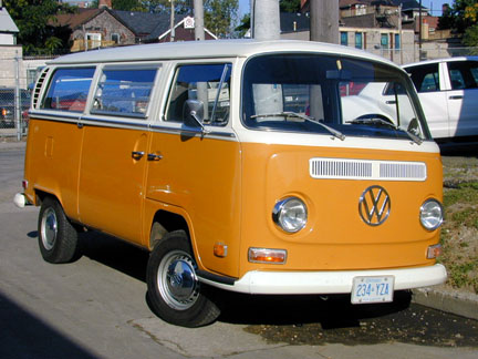

I learned how to drive in a VW van and when my Dad gave me his I sold my Datsun truck. Put curtains on the window and pulled out the center seat, threw in a piece of shag carpet and a folding futon mattress. It became my surf-mobile for dawn-patrol. Loved that van until one day it burst into flames while I was driving home from work. :cry:
After that I bought a 65 Mustang GT Fastback but couldn't afford to feed it so sold it and bought a Datsun B210. What an awesomely reliable and fuel efficient cat. Shipped it to the Westcoast and drove it with my new new bride all the way up to Idaho towing a U-Haul trailer back in '81. Great memories.
(Note: Pictures are not of my personal vehicles but just representative pictures of the models owned found via Google)

Ji, to have that VW bus in that pictured condition today 8)

Other than their utter lack of power, the VW Westfalia (Westfailure in the Mountains) were great campers.
