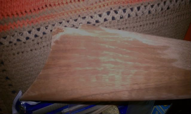

But... having the stock and forend fitted, even is not perfect quite yet, is a big load off! Now to get some transfer markings to knock off the high spots so the buttplate's flat against the wood; rasp and sand away the balance of the unwanted wood! I think'll even as just a straight grained chunk of wood, this'll be nice when hand rubbed with oil! I just splashed some water on it, it ain't smooth nor particularly very well straight now:
It was already starting to lighten as it dried while I was getting the camera!

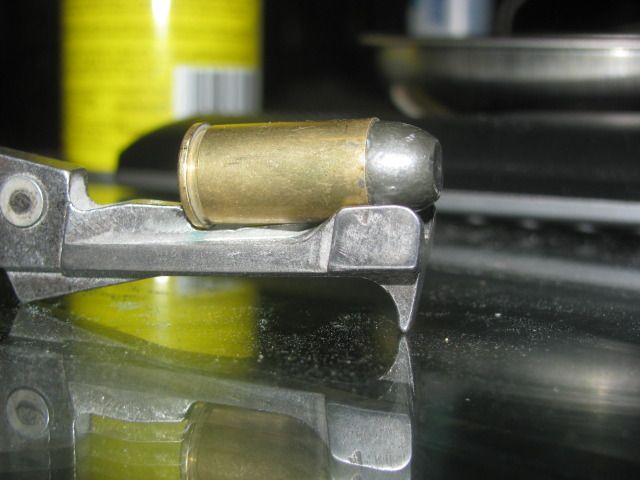

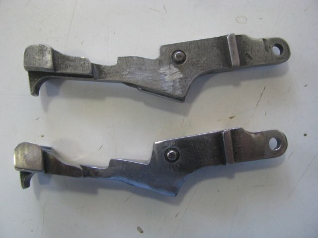

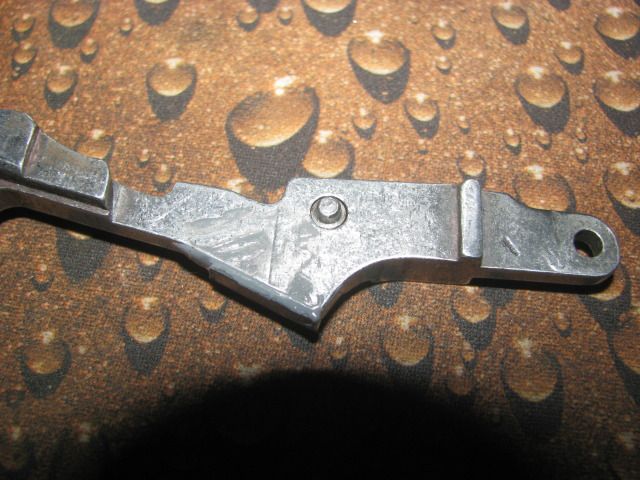

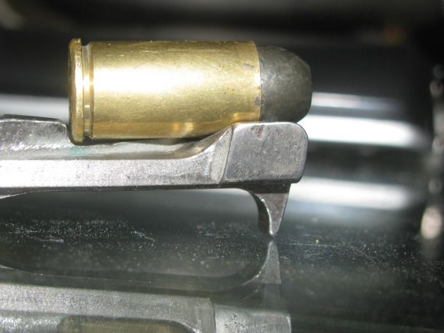

Got the dovetail and mount for the magazine fixed, a front sight dovetail cut, and was ready to start the modification to run Adirondak Jack's Cowboy45Special thru this project gun.
In accordance with instructions at Marauder's Rifle Tuning I started the process of cutting my carrier.
Something's not right still, as I'm still getting part of a 2nd round onto the carrier. More thinkin' is obviously called for!

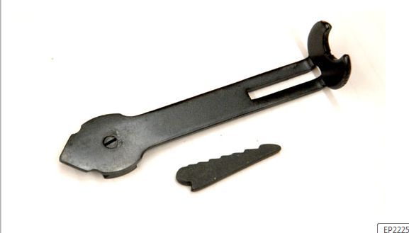

how about, like so,
http://www.dixiegunworks.com/product_in ... ts_id=5586
or even this? [i know , not the right model , but maybe.......]
http://www.dixiegunworks.com/product_in ... ts_id=5621
not many marlin specific sights out there.

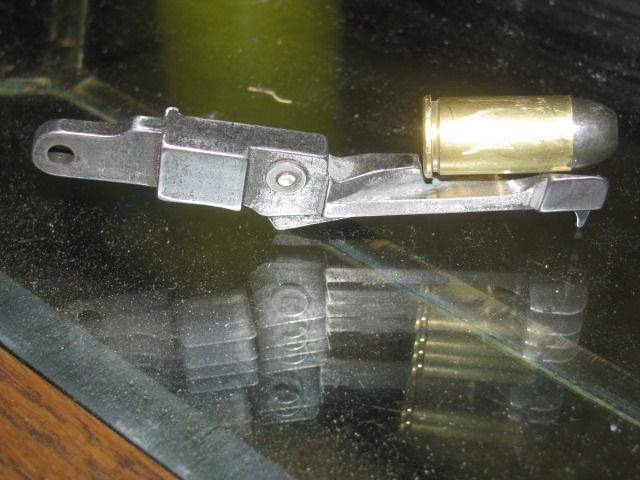

The shooter who developed the necessary modification to the Marlin carrier to run the C45S and 45Colt sent me his for comparison.
While I have the bottom of mine built up, it's not shaped correctly for the timing to be good for both cartridges. It will feed and cycle the C45S pretty good... I probably need a few tweeks to get my feeding smoothed out. Every once in awhile, it seems to hang a cartridge up as it comes out of the magazine. Timing might be just a tad fast!
You might not be able to see it in that pic, but I need to do a LOT of polishing to have mine as smooth and slick as his. And you can't see it, but where the stock carrier, (and mine with the added height), is flat, his is sorta rounded with a slight rolling indention in the middle of the ramp. This allows the carrier to slow as it comes down, leaving a longer time for the much longer 45Colt to get completely out of the magazine before the carrier comes back up as the lever comes agains the lower tang, again blocking off the magazine. Complicated, but not overly so. It took this dumb cowboy a LOT of looking with the gun apart and only the carrier and lever in the gun to finally SEE the actions being made by both pieces.
Hopefully I'll get a video of the action when I get it working.
Mine by itself, showing the amount I built up on the bottom ramp of the carrier:

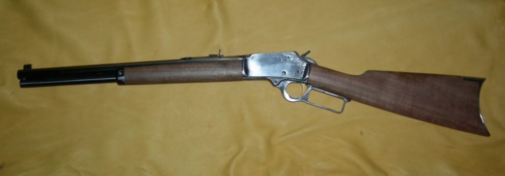

Well... It's been a LONG process, but... no don't get yer hopes up, it ain't done, YET!
But, it has been assembled, and is ready to RUN! It's pretty tight for a speed gun, and I might have the lever short-stroked yet... for I like a nice tight action.
Overall view.

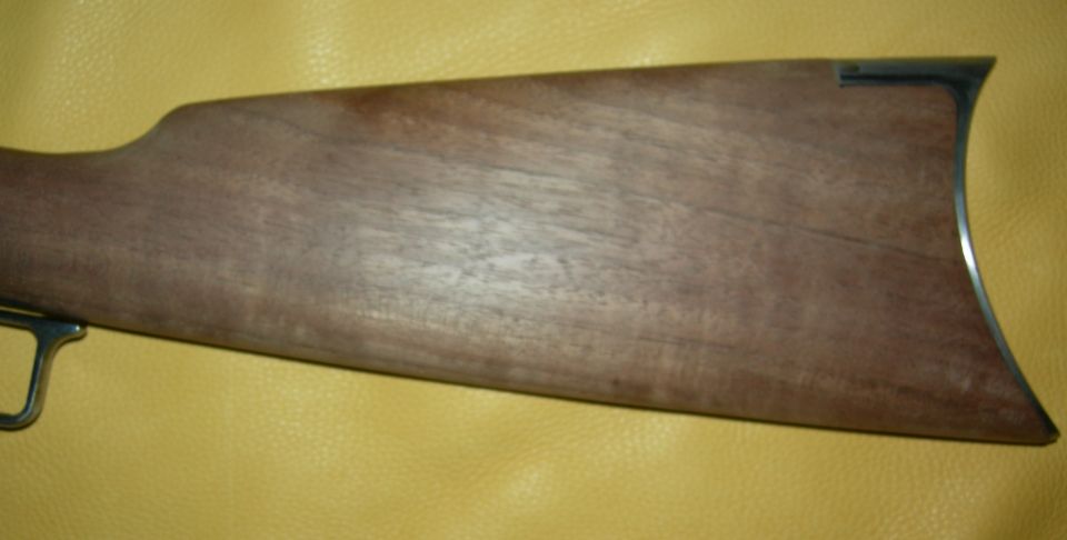

Stock:

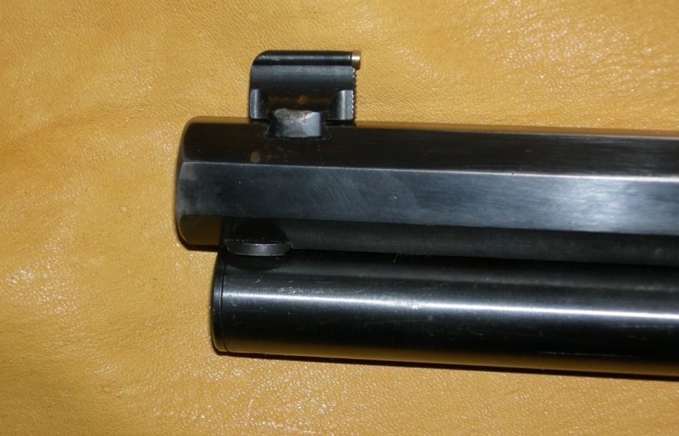

Front sight:

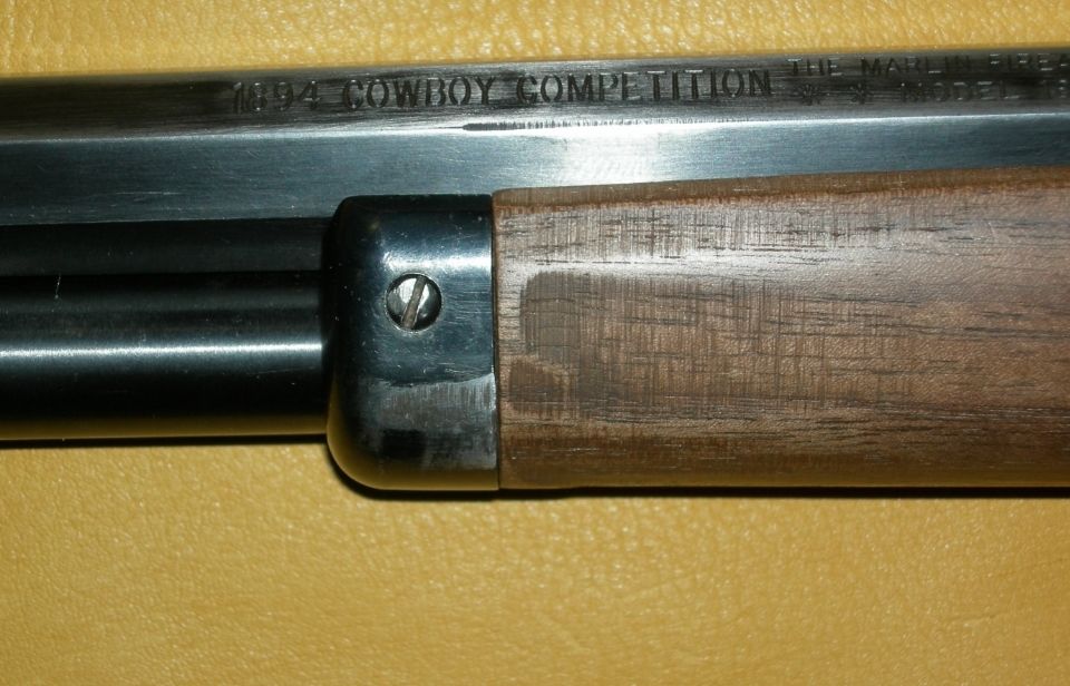

You'll have to forgive the rough appearance of the fore-end... I tried a new piece of equipment... an upright sander to speed up the sanding... went a little deep. A new fore-end is on the way, along with a new cap.
The other side of the fore-end is perfect... but, what's a little faux pa amongst us do-it-yourselfers... I figure it takes a few mistakes to learn properly!

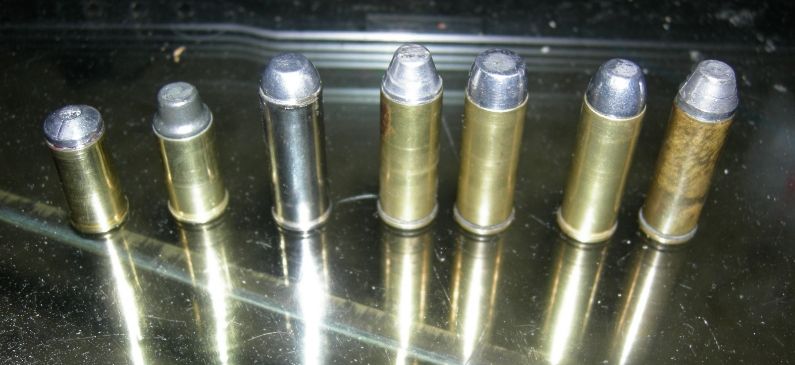

I had one stage where I just shot a variety of bullets thru it. While I don't have five of these loaded up to show, the 6 from the right were all run thru the rifle in C45S cases... at least a couple of each. The only round I didn't use was the one on the far left, a little 125 grain hollow-base that Adirondack Jack sent me a few of when I ordered my cases. I'll be ordering some more cases shortly.
From left to right: 125gr. AJ Special, 185gr SWC poly coated, 160gr RFN, 160gr TC, 185gr WFN, 200gr RFN, and the 225gr TC. I cast the 160 & 225TCs along with the 185WFN.

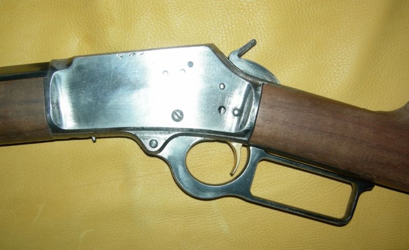

A few swipes with sandpaper and some polishing, and it's off to the refinisher. It sorta feels like I'm putting lipstick on a pig... but, what the heck? Might as well do it right after this much work! I'll probably use Turnbulls. The last guy I emailed hasn't responded, so if they're over loaded with work, no problem. I know Tunrbull's can handle it!
Ugly, unwanted, saddle ring hole:
Viola! No hole:
Not to worry about the tiny divot next to the hammer screw hole, it was a bit of corrosion from when I got it, I think the rest will smooth out with some 600grit and 1000grit sanding. Then polish. I figure with the CCH it'll mostly all disappear.

Friday was a Range Officer course, then a couple of mock stages to test our new-found "Range Officerin'" skills... Found the rifle shot about 2" left, moved the front sight to the center of the top flat (no, it wasn't there initially... don't ask why, how would I know, I just pushed it in and whacked it with a drift a coupla times)! And viola! Shot to point of aim out to about 150 yards!!!! Well, ok, it rang steel out there, I couldn't tell which lead smear was mine!
