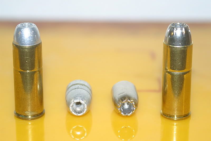

Last March I purchased a new box of Winchester .45 Colt 225 STHP ammo. I purchased the previous box in August of ’02. I shoot very little factory ammo, and even less of the fancy STHP stuff. That is relegated to my home defense guns. My normal routine is to buy a new box every year or so and shoot up the old box. Well when I opened the new box the ammo looked different.
The new box of STHPs has a different bullet. The first thing I noticed was its color. Not the dull aluminum the old STHPs were made from, but a smooth polished plated silver look. Almost like nickel plating. The next thing I noticed was the hollow point was different. Instead of a wide opening tapering down to a narrow bottom, this one was wide all the way down. Right about 3/16” all the way down.
So I decided to do some comparisons. I took one of the new factory loads apart to compare the bullet to one I have in my bullet collection.
Here is what I found:
The bullet is copper jacketed with a silver colored plating; you can see the copper in the cuts at the edges of the hollow point. There is no lube grove as with the older aluminum bullet.

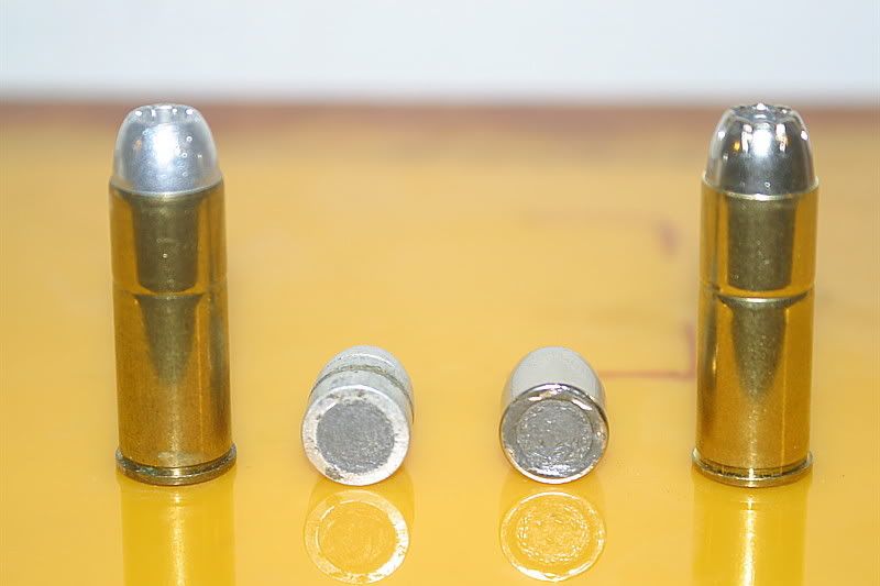

The base is however open like a FMJ bullet, just like the old bullet.
And the hollow point itself. I can’t get close enough with my camera, I hope it’s visable.

As an aside I checked the powder charge and it was 8.6grs of a dull grey round disc shaped powder that looked a lot like Bullseye.
These new .45 Colt bullet look like the ones in the box of .357 Magnum STHPs we bought in November of ’06.
I thought this was interesting enough to share.
