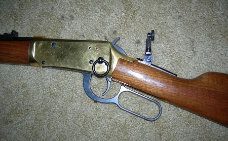

I am looking for tips on improving the action and trigger feel on some Winchester Model 94's. I have been away from shooting for many years and need all the help I can get from the rifles to be able to hit anything. I have three 30-30's that were bought around 2005-2006 and stored away, unfired. One is a 1966 Canadian Centennial (octagon barrel) top eject and two are angle ejects from the final years of the New Haven factory (one is cross-bolt safety, the other a tang safety). I have run the actions of the top-eject and one of the angle-ejects a couple hundred times to smooth them out. I have the blisters to show for it.
I have no experience with lever action rifles and don't know what is considered normal and what can be improved. On the 1966 rifle, the trigger is pretty good, but the resistance from the lever when cocking the hammer is enough that I cannot run the action with the buttstock against my shoulder. I have to lower it from my shoulder for increased leverage (pun intended). I would like to know if it is possible to reduce the hammer spring tension to make cycling easier.
On the side-ejects, it is much easier to run the actions, but the triggers are terrible. I have been away from shooting for a long time and would like to start plinking again, but I am pretty certain that I won't be able to hit what I am aiming at with those triggers.
Any advice would be appreciated. Thanks

Fess , Welcome to Leverguns....I will "try" to keep this short and simple. I came to this forum 21 years ago with much the same questions You now have. After being away from most long guns for 15 years I bought a new Winchester USRAC .45 colt. 24" barrel... out of the box it was all I could ask for simply beautiful .
Trying to shoot it was horrible to say the least , all of the springs in it were way to stiff , hard to work the lever and had about a 10lb trigger. the only thing that was easy to move was the tang safety . even trying to load it thru the loading gate was a thumb buster.
It was a common problem at the time and there are all kind of fixes to smooth up the action and make things better / easier to work . I did a bunch of them and as far as I'm concerned it was a total waste of time . when they put the rebounding hammers and trigger groups in the guns they were ruined. John Browning didn't design it that way. You can do what ever You see fit but I would NEVER , NEVER , NEVER , own anything with a rebounding hammer again. I would sell the ones with the rebounder . these problems have also carried over to a lot other lever guns that had the rebounding hammer assembly.
I wish You the best of Luck.
And I must add , get a Winchester made pre '64 and it's a whole different Gun. they were never made to have a rebounding hammer or all the other parts.

Id start off on all of them, but in particular the older one, with a good cleaning of the action with solvent and toothbrush to get rid of old gummy oil and sludge, then lubricate well. Ive never seen a 94 that was so hard to cycle it couldnt be done from the shoulder.
The rebound guns can be improved as to trigger pull, Ive handled several that were fine without work or responded to mild burnishing or clean up. Burnishing being putting 10-15 lbs pressure on the back of the hammer then pulling the trigger a half dozen times, then check, repeat as needed. It pressure polishes the sear surfaces to some degree and often helps the trigger pull weight and smooths it out some from gritty feeling pulls.

All except the bottom one. Angle ejects do not have the slots cut in the sides of the receiver to fit the standard top eject lower tang. The middle is the best option, produced from about 1975 until the introduction of the rebounding hammer.Tycer wrote: ↑Thu Feb 11, 2021 10:45 amgreat adviceMalamute wrote: ↑Thu Feb 11, 2021 9:28 amId start off on all of them, but in particular the older one, with a good cleaning of the action with solvent and toothbrush to get rid of old gummy oil and sludge, then lubricate well. Ive never seen a 94 that was so hard to cycle it couldnt be done from the shoulder.

Winchester 94 actions can be off-putting to those unfamiliar with them. The have a sort of ratcheting action as the lever pushes the link down and gains the extra length to push the bolt far enough to the rear to feed that .30-30 cartridge. It' been described as "dropping its guts out" as it's cycled. The '66 Centennial was produced in the period when Winchester used a flat bottomed hammer and a two piece mainspring as pictured in Tycer's bottom example. The springs tend to be a tad stiff (IMO), lack the smooth increase in pressure of the later coil spring and the smooth build up of the early stirrup type hammer and flat spring. But, should still cycle easily from the shoulder. At least my example (20" octagon '66 Centennial) does.
As said, clean the action thoroughly, ensure the button at the back of the link compresses easily and disengages from the lower tang readily. If this is stuck, it can wear that lower tang and cease to hold the action closed as designed. There should still be enough movement in the lever to release the trigger block safety, requiring the lever to held against the lower tang to fire the gun.
I like to disassemble mine to be able to stone the mating surfaces and remove any burrs the factory left behind. I don't recall the retail price of the '66 Centennial, but my '69 44Mag was $93.69... and even in 1969 that was "cheap"... not a lot of hand fitted was being done on any of the post '64 model 94s. And they certainly benefit a LOT by the owner taking the time to do what the factory didn't!

I too, detest the rebounding hammers. I have one 94AE. It is pre-crossbolt, but had a rebounder. I swapped in the earliest post-64 version of lower tang and fire control group. I found the parts easier to source. As my buddy Griff mentioned above, the only thing that prevents thus assembly from being a direct swap is the tenons on the sides of the lower tang that mate to earlier receivers. I just filed them flat to the lower tang, touched up the finish, and it went right in.
I actually use this little 44 Trapper a lot. It's a pretty fair shooter and quite handy. One advantage of an Angle Eject is the many more sighting options open to it. Mine has been a guinea pig for much experimentation. It's had scout scopes, red dots, conventional scopes, etc.
My favorite is the excellent XS peep that it wears now. Another advocate an Angle Eject.
In the pictures, you can see the tenons mentioned above, a comparison of both lower tang assemblies as the install. The last is the XS peep.
