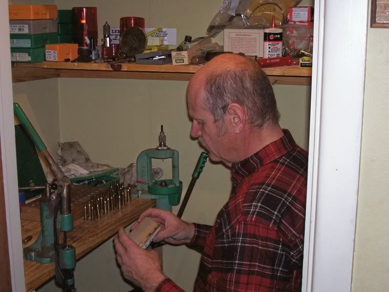

I don't have pictures showing the whole setup, but hopefully you can see that it all (just reloading, not casting and gunsmithing) stuff is in one closet.
It's in an otherwise unused room for now, but the closet has it's own lock and works pretty well.
20Cows, you do, indeed, have a very nice little closet reloading room! Nice.

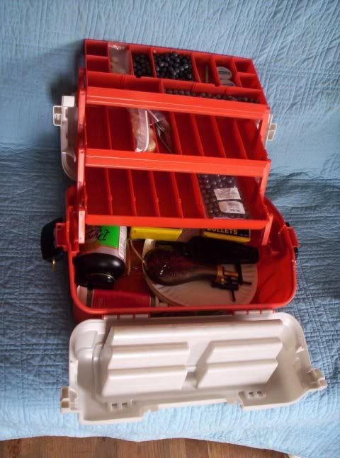

my setup is pretty simple, as I am only loading three calibers: .38/357, 45lc, 45-70. I have a dillon press on the end of my huge navy work table, and the other items fit under the table until needed. My scale, tumbler, and powder/brass/primers resider (in ammo cans) and loading book take up very little room under the table. My molds and melting furnace and lead reside in garage. Loaded ammo in plastic boxes are sorted by caliber and stored near the gun rack.
I keep my blackpowder items in another large carry box which has powder, primers, balls, caps and cleaning gear for my 2 1851's, 2 ROA's, and my .54 flintlock. Molds for the balls and bullets for these guns are in the garage.
