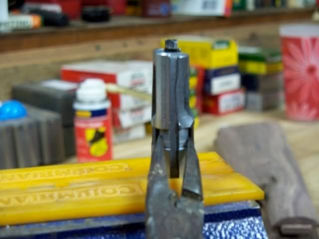

Put the bolt in a vice & push it off. A pair of needlenose pliers work real good.
Heres a not so great picture of how I do it. Open the pliers so the tips bear on the open ends of the extractor & push it off.:wink:
