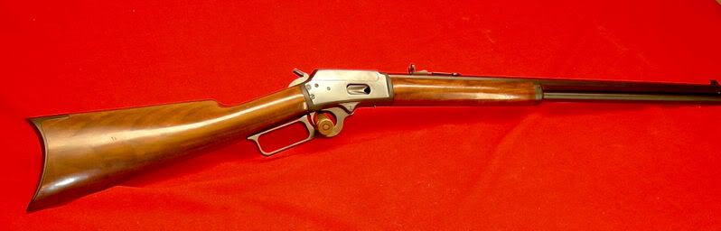

Here's a Marlin 1894 CB that has had a cresent plate cut in and the forwood slimmed. It was then Tru-oil-ed and 4/0 steel wooled in between but toward the final coats is was also block sanded with 600 wet.
If I want stain I will tint the tru-oil. This 92 was tru-oiled tinted with red krylon paint.
Doing it like this allows more control over the color. If you want more color just keep adding tinted tru-oil. For less start with the tinted and finish with the untinted.

Nate, those are really nicely done. That Red 92 is amazing, I'd really love to see that against a lighter colored background.
That CB stock has a great finish on it, too. I definitely like the sheen on it.

Yep, the red background tends to make it look more red than it really is.
I like the color you got, too.
