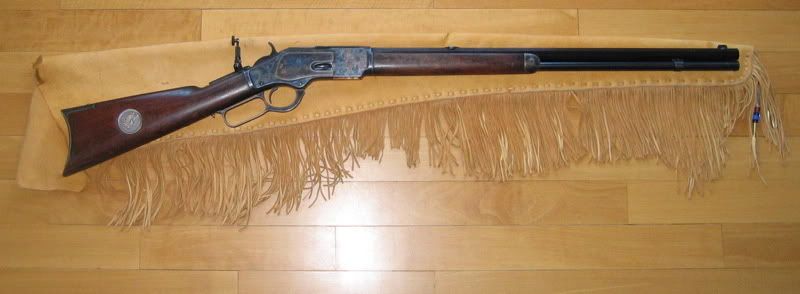

Another option available to you is to rebuild it as a 44-40 or 38-40. All that is needed is the larger caliber carrier and bolt assembly, and a barrel/mag tube of course. The last carrier I bought off e-bay was $58 and a bolt generally runs about the same. As for the barrel, originals are available and if you really want a nice shooter then put on a Badger barrel. As for the wood, replacement can be expensive. However, unless the wood is just trashed, you may find that by cleaning it up it will be very servicable, and new wood looks goofy on old guns!
Of course, the cheapest thing would be to buy a reproduction - but that would not be near as much fun!
As for the prices for original 1873s they seem to have taken a jump recently. I was at a gunshow yesterday, and the only Winchester 1873 priced at anything close ($1600) to an Uberti was JUNK! Most were what I would consider $2000 rifles with $4500 and above on the tag. Nobody was moving on their prices either!
This rifle started out like the one you describe. By the way, the wood is the original stuff just cleaned up.
