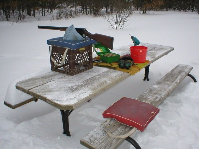

Last week I published some loads I planned on shooting some BPCR out of my 1895CB. I didn't get real fancy because of the snow, etc. but the first order of the day was to set up my "technically correct" shooting stand. Not fancy, but it works for me.

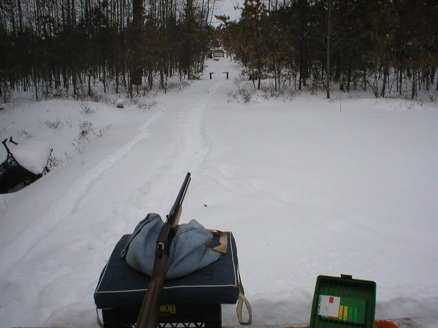

Next, it was time to put some targets up on the 50 yard line.

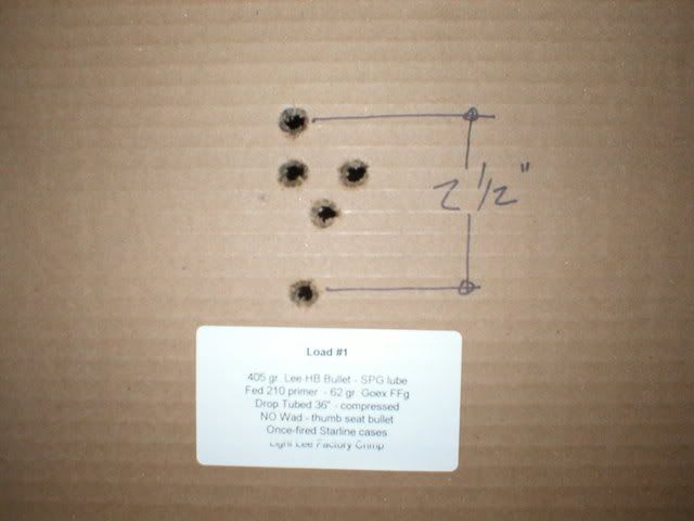

Now shoot the first round of 5...........

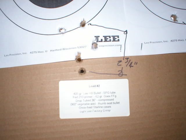

Stroke the bore with a couple wet, and a couple dry patches, and out again, round #2:
Repeat the cleaning and then round #3:

1st conclusion:
Man, that was fun!!!!!
2nd conclusion:
Load #1 configuration holds the most promise so far. As soon as I'm able to mount the Marbles tang sights on the rifle I will shoot more of these playing with powder loads.
