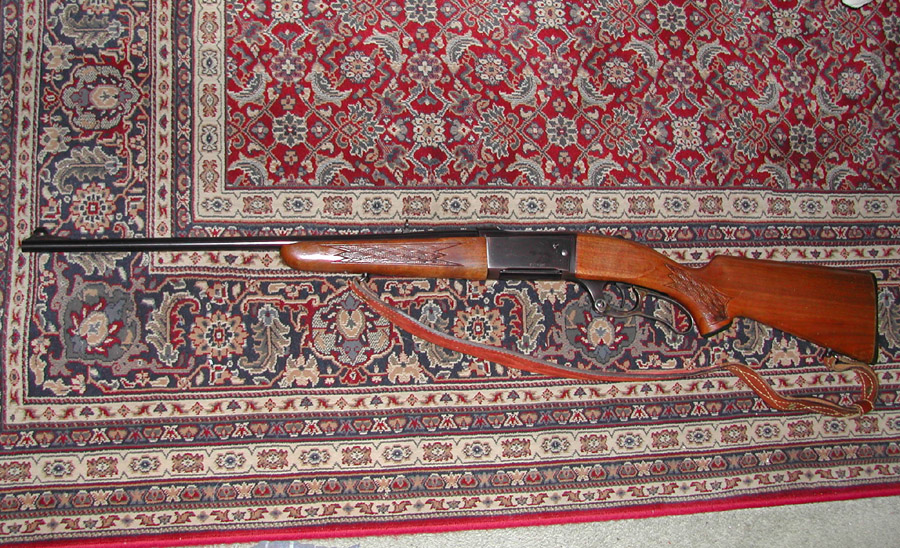

My .300 is an EG of 1953 issue, and IMHO the Williams goes with it just fine.
