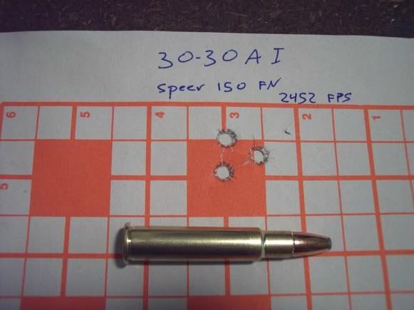

Without pushing things to the extreme, I get 2500 fps with 150 gr. Speers and RL-15. About 150 fps more than my best load before I rechambered it. I saw no discernable change in accuracy from the reaming. As to whether or not it's worth it, is a matter of opinion. To me it was. Not only do I have more velocity and longer case life, I have something not everybody else does. The cartridges are just plain cool looking too.

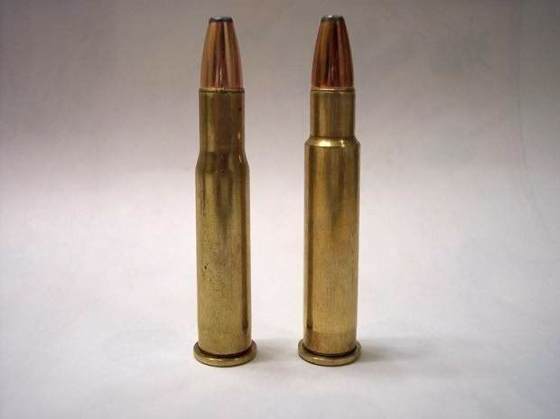

Rusty,Rusty wrote:Ted could you explain the case life issue and maybe post pictures of the two cases?
Thanks,
Rusty <><
Here's another photo with the 30-30 and the Ackley version together.
J Miller,
I have yet to trim any of my Ackley cases and some of them have been loaded 6 times. They take very little sizing when reloading. I think the case life issue is not a big deal with the 30-30 because, as you stated, case life with the standard 30-30 can be quite good when handled properly. I believe it becomes more of an issue with higher pressure rounds. I have a 375 H&H that will let me load new brass 3 times before I start getting case head separations. Those are long tapered cases, and I bet there would be a dramatic improvement in case life if I rechambered it to the AI version.
