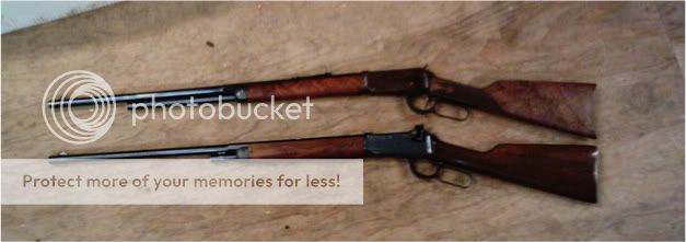

two "custom" 94s,top '75 action browned w/38-55 barrel from buffalo arms stocks from numrich and
misc hardware from my parts bin. a work in progress, but already shoots fine. may have to break it
down again to have the chamber reamed a few thou bigger, works ok w/jacketed but too tight for the
proper lead bullets.
bottom is a '62 back half and the front end kit from numrich. i did this one a couple of years ago and
really like it. anyone wanting to do this kit i can well recommend it. you will want to be aware that
the parts come as just that, parts. the forearm is unfinished and oversize, and the metal is blued, but
alittle rough. still a good plan if you like 26" barrels though.
