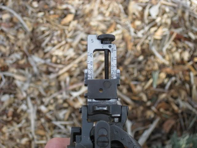

At the range later, the rifle seemed to work well, but was shooting 6-8 inches to the right. I have a sight ajustment "screw driver" that Jim fabricated for me from an Allen wrench. It fits the strange screw head that releases pressure on the front sight and allows you to drift it. Unfortunately, we forgot to bring a socket to the range to use it. It was not a total loss. I was able to hit the steel targets at 200, 300 and 400 yards off hand after sighting in off the bench when I adjusted my aim and did my part. The trigger on this rifle is terrible but I will get that taken care of. I will probably go with an aftermarket ball bearing trigger that is a drop-in and not modify the stock trigger which is stamped with the Savage block "S".

I took some more pics of the Enfield at home in lieu of not taking pics at the range.
