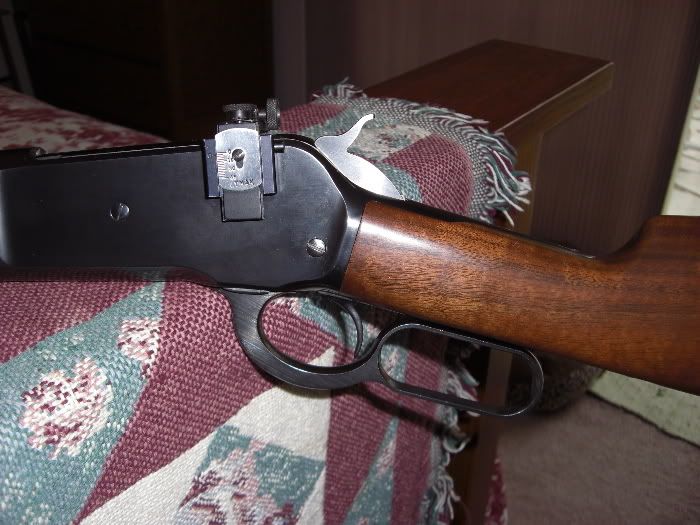

Firstly, I wan't happy with the crescent butt on the PG Miroku 86 that I converted, so last Saturday the tang, lever and stock were replaced with the factory parts and it is now straight gripped, again. It fits me much better this way. If I ever find a PG Shotgun butt that fits, it may go back in that configuration, but this will do for the time being.Image

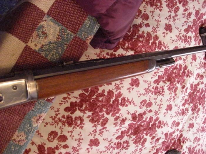

Next, with the help of Mike Hunter's expertise, I was able to get the .38-56 front end to fit correctly on one of my old TDs. Now, all I gotta do is shoot the darned thing to see how it does. Should do fine as the bore is mint and tight. I'm doubly happy to say the least. :D :D

Pistol gripped guns for some reason do not agree with me. Maybe its because I never could afford a nice deluxe gun and stayed with the straight jobs on which I learned on. Plus, watching all those Westerns while growing up all had straight stocks and I just had to be like them.
I like that half rd/oct. barrel on your '86. The 38-56 is one cartridge I never played with so I can't help you much. Guys I do know who have played with it say it is plagued with the same issues as the 38-55. In other words, large groove diameters with a chamber that will not accept the bullet it needs. Take any measurements yet?-------Sixgun. (btw, if it don't shoot well, just send it to me--the WHOLE gun :D :D

I have a couple of other .38-56s and have loaded that one for years. This gun has a later, NS barrel that will accept .375 bullets, unlike the .380s that earlier, "BP" guns seem to require. I haven't actually slugged the bore, but .375 jacketed at the muzzle leaves deep rifling marks when tapped in a ways. I have several sized dummy rds to run through the action and they all chamber OK. The larger diameters are a bit tight, it seems, which leads me to believe that the smaller ones will function accurately. A trip to the ranch will tell, soon enough. :)
Re: 2 1886 problems "corrected"
Cool stuff Mike!!
Always thought a 38-56 would be interesting.
