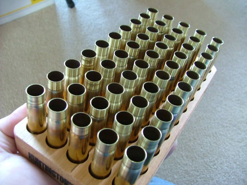

We started with 50 pieces of Quality Cartridge 450 Alaskan brass. These were probably formed from 50-110 basic brass, annealed, and then headstamped. The last time out, I had some very erratic velocities and so I quit shooting what I had loaded and did some measuring. This showed that the necks were too thick and needed a bit of a trim. The ends of the necks were also a bit uneven on some pieces.

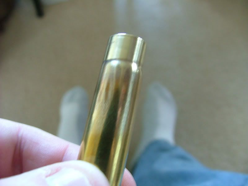

The best part of outside neck turning by hand is that part when it's finally done ...

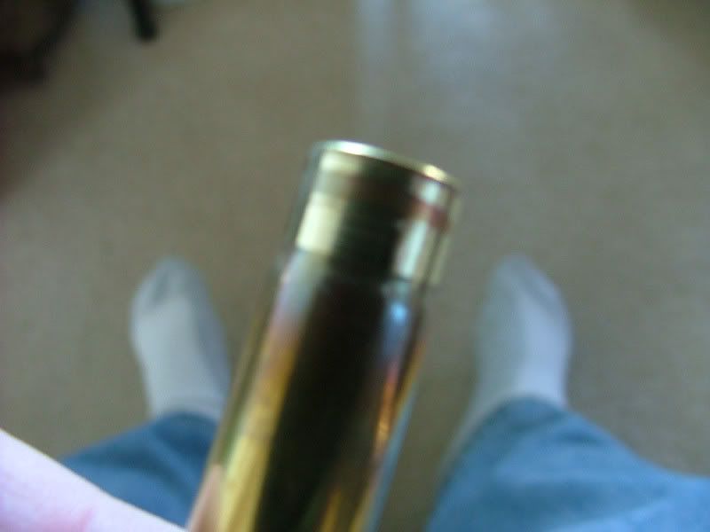

Here I've twisted the case in a piece of 3000 grit polishing cloth to show the ripples in this new brass ... probably from the forming operation in dies. It's hard to see or feel and is only highlighted by the polishing cloth missing the low spots in the ripples. In honor of YK, the next few shots will show my socks ... very much out of focus ...

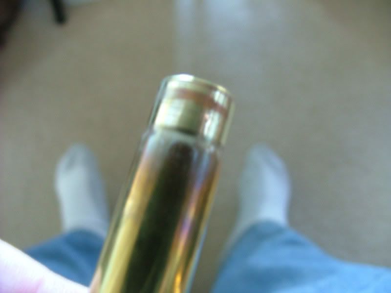

The cases were apparently heated on only one side when annealed ...
The neck thickness varied a bit and here you can see the Forster cutter didn't take brass from some of the low spots on the neck. I only took off 0.0015" all the way around for a total outside reduction of 0.003" in diameter. I suppose a thicker neck is to be expected when a larger case is swaged down ...

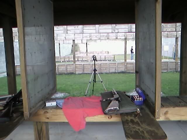

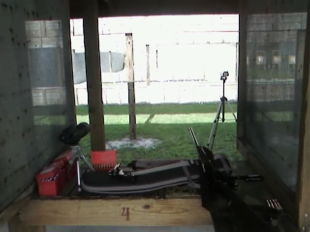

I met up with Rihmfire and Duff L Bagg at the range this morning. As usual, I was 30 minutes late. This is my stall with my chronograph setup about 15 feet away. There wasn't enough light to bring it in any closer so all velocities will be at about 15 feet from the muzzle. At 15 feet, I'm amazed I didn't shoot it ... I gave it a pretty generous holdover.

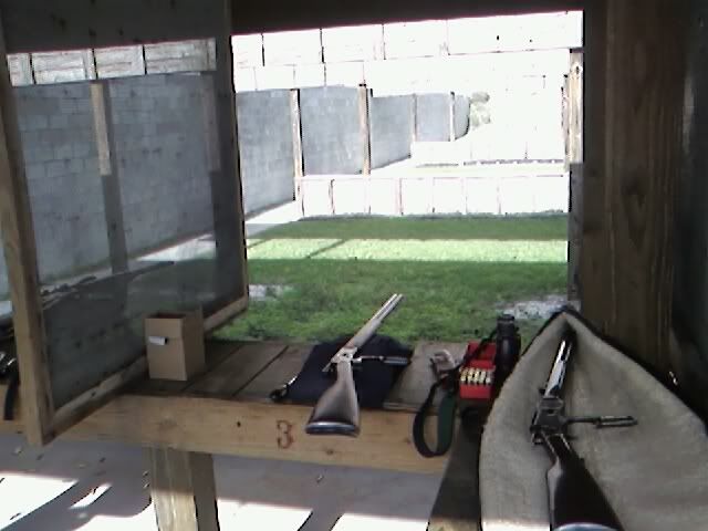

This is Duff L Bagg's stall with his 1895 in 405. We're not exactly a quiet group ...
This is Rihmfire doubling down with a '92 and a nice Italian '73 ...
