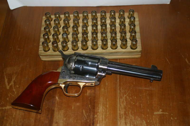

Hope this isn't too out of place but; would it not make sense to think Uberti uses the same coloring method on their revolvers that they do on their rifles? The reason I ask is my IJ still has some pretty blatant colors even after being abused and being over 30+ years old.
When I got it there was a clear coat on the frame, that's long gone now. There's been Hoppe's on it, other cleaners too. But the colors are still there.
If Uberti is using the same coloring method they used on these older Cattleman revolvers, it's no wonder Grizzly Adams 1873 still has it's color.
