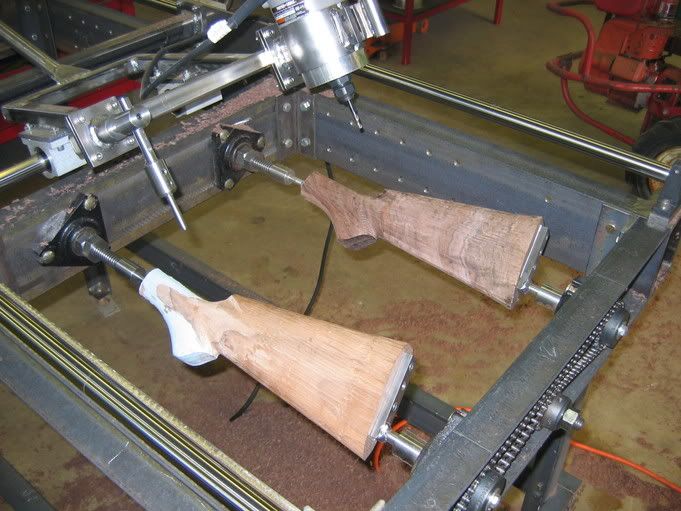

I suggest if you are going to use a very high grade piece of wood that you cut pattern stock out of cheep wood made as a copy of your patern you are making. It can be fitted to the gun without worry of close inletting and any changes made you want then Glass bed the new pattern to your gun. Now you have an accurate pattern to use when cutting that valuable piece of walnut you have been hording.
The duplicator in the picture is one I made and have in my shop In Ridgefield Wa. Iwould let you use it to make your pattern if you want.
I am also a gun tinkerer so like to be of help if I can. Chuck

Chuck 100 yd wrote: The duplicator in the picture is one I made and have in my shop In Ridgefield Wa. Iwould let you use it to make your pattern if you want.
If you ever wanted to write up something on how you made the duplicator, I'm sure forum members would really like that! Most of us don't have the skills to build one, but it would still be of interest, and in my case I have a friend who is a welder and another who is a machinist, so perhaps I could talk them into building "us" one :wink: .
Re: Stock making from scratch-Part 1 lots of pics.
AJMD429 , That is an idea. Pictures are worth 1000 words as they say.
Maybe I can post a few pictures with fewer words. I built it using linear bearings and shafting as guides. That is a very accurate way to guide the router but is dificult to operate (requires too much muscle) and is very expensive to build. Dont get me wrong, It works well but I plan to modify the design when I get time to make it like most duplicators that have a track on each side with a simple wheel that rolls along like a rail cars wheels. :D
Enough of ME! This is Vall`s thread! :D
