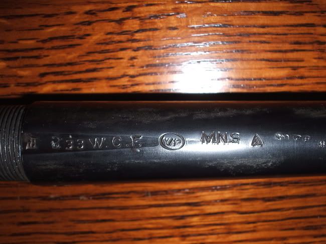

This is for information purposes only, but in my brief time studying early model Winchester barrels it has come to my attention that some BP caliber guns have nickel steel barrels, despite the marking not appearing on the side of the barrel, below the rear sight. Most later 1886, and some 1894 Models have NS barrels, but they are marked only M.N.S.(Midvale Nickel Steel), on the flat at the bottom. The .30 WCF and 32 WS '94s are all marked on the barrel side. The same marking is seen on the .33 WCF, and other caliber lightweight 1886s.
An example of a non-top marked 1894 is this .32-40 carbine barrel. The barrel steel is noted at the bottom flat as previously mentioned.
If the barrel steel on BP caliber 1894s is of interest to you, a look at the markings on the barrel bottom tell the complete story.

Wow ... cool info. Great with the pictures.

Sixgun, the following came from Bert H. over on the Winchester forum. He has done much research on the pre-war guns, especially the 1885. This is what he noted on a subject of Model 94 .32-40 and .38-55 barrels.
"The standard barrel material used for the 32-40 and 38-55 was referred to as "high pressure steel" versus ordnance steel. It had a tensile strength of 60,000 pounds versus the 110,000 pounds for the nickel steel barrels."
I have searched high and low for NS barrels and was fortunate to find this example with Joe Salter. I'll use it to assemble an good SRC from a shot out one. There are few octagonal barreled nickel steel '94s for sale on web sites as we speak. When I recently called one seller about one of these guns he informed me that the price had moved up $1100. I explained that his site definitely had the lower price, but he lamely claimed that it a "sale price" and the sale was over. Then he allowed that I probably couldn't have afforded the gun anyway. That was an interesting statement, but I just let it slide and told him thanks for his time. :lol:
