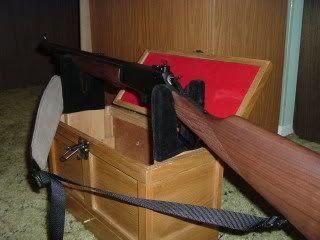

XS sights or Skinner sights are good quality products that should do the trick for you. Aperture sights or ghost sights work for older eyes because you focus only on the front sight and let the rear aperture ring blur or "ghost". I like to use a bead front sight with mine and place the "dot" in the center of the aperture - which is naturally where your eyes want to put it...
Here's a pic of an XS rear sight on a 336 (.356 Winchester):
Notice that the front sight blade is quite high - you will most likely need a .530 or even .600" high blade - mine is a Marbles 1/16" brass bead - .530".
