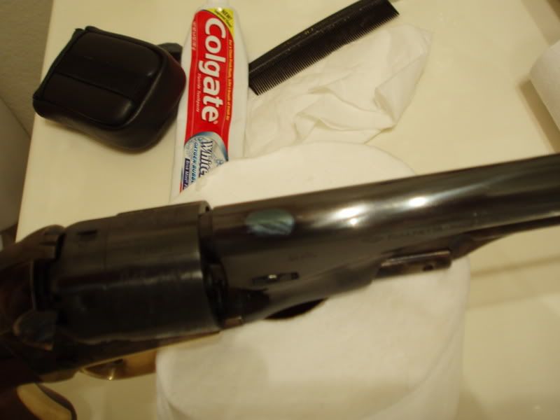

Using cold blue on a new Pietta revolver to touch up a couple of minor scratches resulted in a gray blue spot lighter than the original deepish blue.

I use Oxpho (sp?) Blue from Brownells. You can use it for several coatings to bring the cold blue color up to match the original gun's bluing.

Modoc beat me to it - I use Oxpho Blue from Brownells. The Birchwood Casey stuff from Walmart is stuff.
Degrease, use a torch to heat the area and apply the Oxpho. It won't be a perfect match but much better than the BC stuff.
You could just "antique" the pistol. Use blue remover (the BC remover works fine) and then it'd be in the white - let it rust a bit or apply some vinegar and you can get a nice patina look.

I have used BC Super Blue and the regular strength and this is 44/40 and they have worked fine on the other firearms I have applied them to. Thanks for the info - I will have to try the Brownell's product.
Oh well, time to get this out and shoot it with BP anyway. Some might think it a character flaw that I like to keep my guns so nice.

+1 x 1,000 on the Brownell's Oxpho Blue-- it's great stuff!
But -- most important -- get the "paste" not the liquid...
It is "thicker-er" (for lack of a better word!) and has much better "cling" to smooth gun parts that are typically rounded. I found I got better results with the paste, than with their liquid.

Stopped by to see the gunsmith about this - he gave me an 8 oz bottle of the cream Oxpho Blue - now the 1/2" x 1/4" oval is an azure blue. Easy stuff to use - thanks for the tip. He likes the liquid better - old school he says.

Ysabel - here is a picture from my gunsmith area in my condo.
The azure blue turned to blue/black after sitting a couple days with a bore butter coating. This is following a reapplication of the Oxpho Blue Cream.
