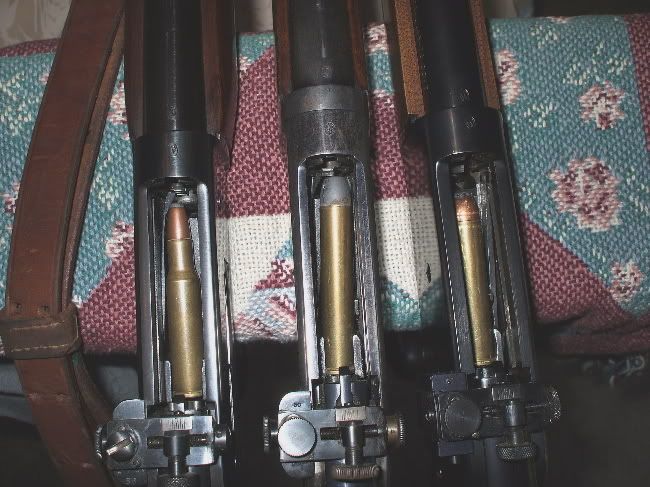

These are what I prefer on a Winchester. :D

Mike D. wrote:These are what I prefer on a Winchester. :D
Just when I thought I'd made a decision :roll:

Mike D, is that a 45-90 or 50-110 takedown in the middle? How hard was THAT to find.

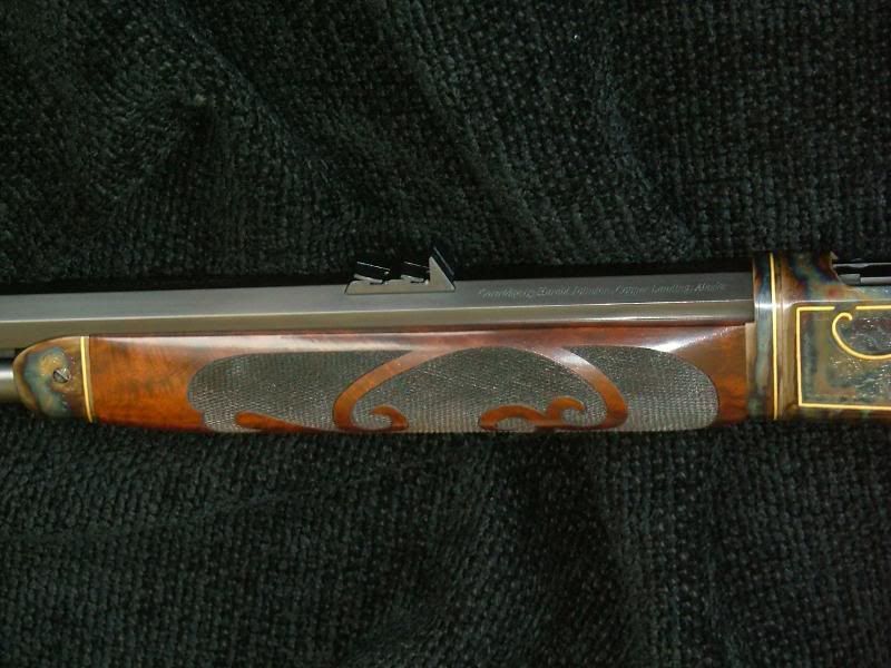

In another thread, El Mac posted a link to some nice 86's by Johnson that happen to have some interesting express sights on them. Here's a link directly to one of the rifles ...
Express Sights on High End 86 Takedown
Nice looking setup. Of course, the rifle is around $40k and I'm not sure who made the sights. Maybe someone here will recognize them.
Re: B '86 project dilemma. What sights?
That's COOL!
Thinking I'm going to have the Express sight mounted.
Looks much better with out that big base it came with.
Thanks for the idea!!
It is a .45-90 and not too hard to find. I'm working on another one at this time, but want to prove it's leaving the factory as it is.
The latest is also a LWTD, but has a full magazine. I am waiting to hear from Dave on the gun's authenticity before any move is made on it.
At the cost of these guns nowadays nothing can be left to chance.
Like I said before, I already blew my chances on a .50 EX LWTD a few years ago. The gun was made in 1918 and can't be lettered, same as my .45-90.
I suspected it as a parts gun, but will never know for sure. I could have had that piece for a bit over 4K, is all. Brad has one that he hunts with.
