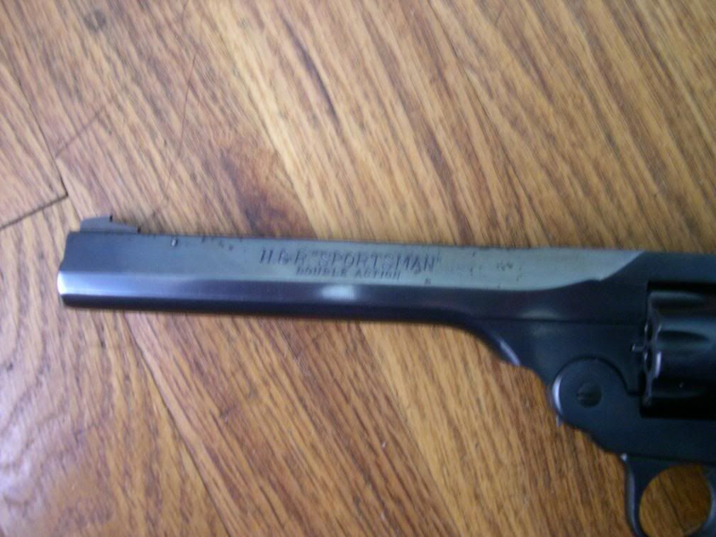

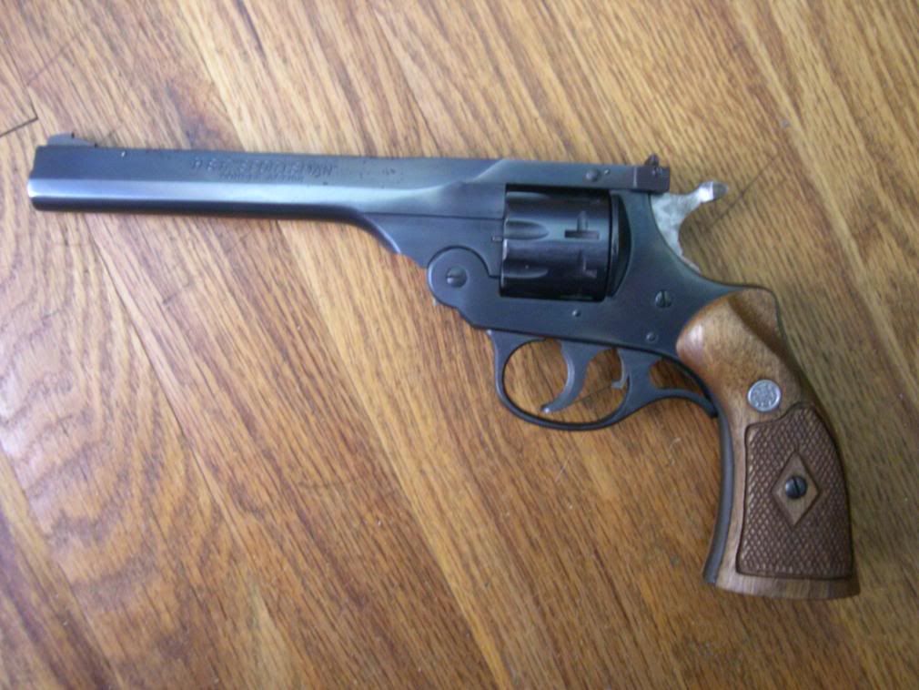

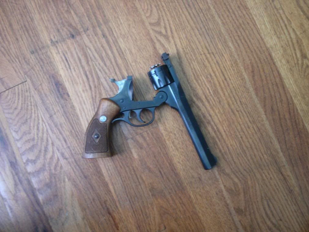

Hello all;
I recently aquired a H&R .22 "Sportsman" revolver. It is a 9 shot, break open revolver with a rear sight adjustble for winage and a front sight adjustable for elevation.
I fired a few boxes out of it so far. Accuracy is decent for the size and age of it, however, it has some functining problems. It loads and extracts hard, although I gave it a good cleaning before shooting it. Also, it misfires one or two shots per cylinder, and I don't think its always the same chamber. The misfired cartridges fire almost always on the second go around.
I intend to take it a little further apart and really clean it with a can of break-clean, then immediately re-oil it. And really scrub the cylinder chambers. Other than that, anyone have some helpful hints?
Thanks.
Sean
Thanks.
Sean

Thanks guys. I do mean that the cartridges are hard to insert, and extract after firing. Also, it is stiff to open, but that is better than being loose and floppy. I'll try cleaning under the star also.
Sean
Sean

Mine is a six inch barrel. The stampings on the barrel are rather light, but still legible. I don't think it was refinished, but even if it was, no big deal.
I plan on taking a needle file to the edge of each chamber where the firing pin may have hit it. It appears that it may be slightly dinged from dry firing. The same with the extractor star. I will go very light, just breaking the edge.
The serial # is N69xx. Any idea when it was made.
Sooner or later, I'll try to put a spacer on the mainspring strut to slightly increace the mainspring pressure. Take-down does look intimitating, especially with driving pins out. It may be awhile before I get to that.
Sean
Sean
