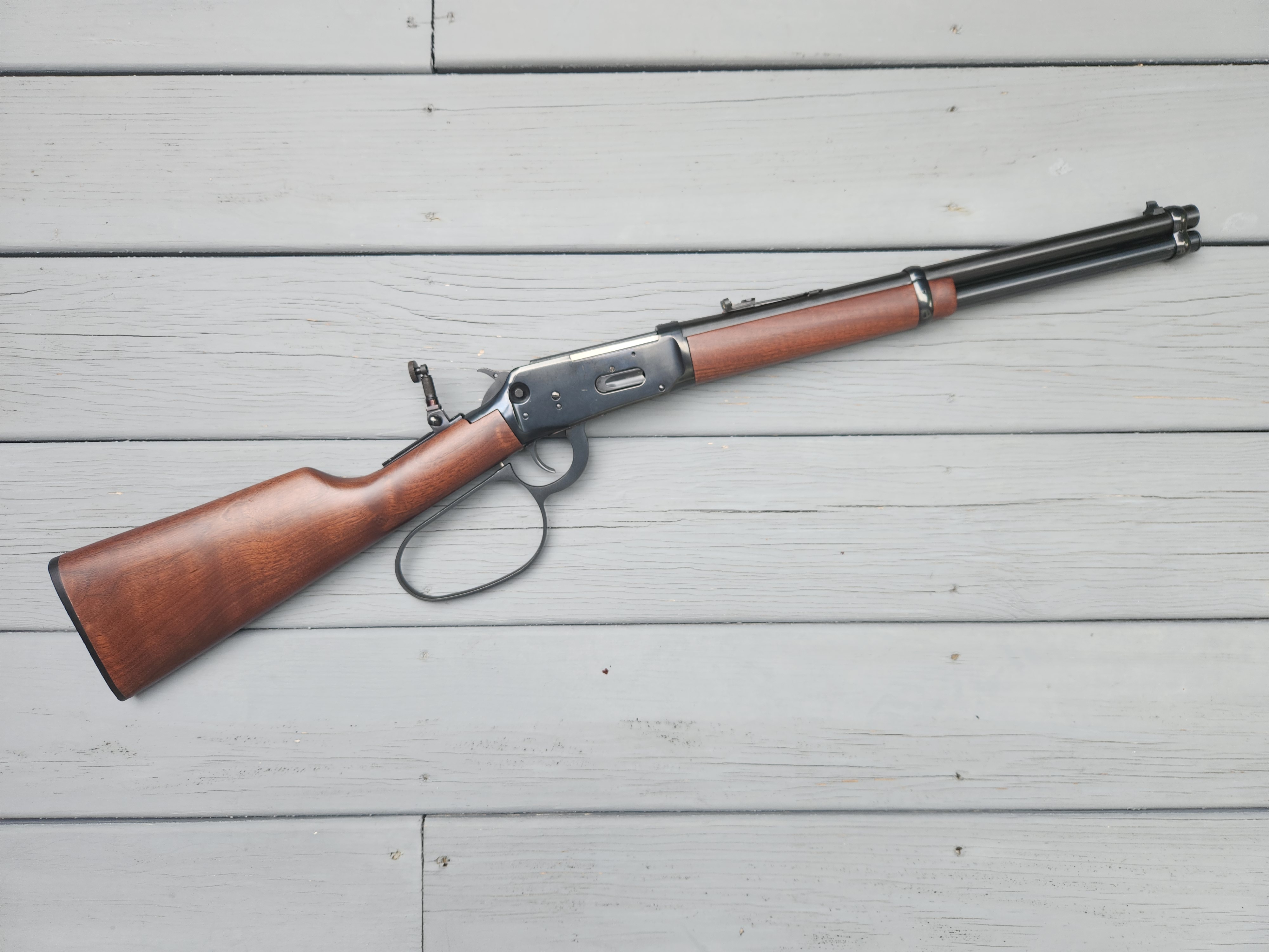

Well I went ahead and brought her home today. She's beautiful, looks to have very few rounds through it. Haven't shot it yet, but did cycle some ammo through it. Seems to cycle just fine. Previous owner said only thing he did to it during the time he owned it was replace the lever with one feom Ranger Point Precision.

Nice figure in that stock. Bet you'll be happy with her.
Re: Tell me about the Winchester 94AE chambered in 45 Colt.
Yes it is beautiful wood for sure Bill. I am floating the idea of getting another stock and cutting it down a few inches to shorten the overall length. Or maybe finding a youth stock. This one is too nice to mess with.Bill in Oregon wrote: ↑Sat Jul 11, 2026 5:32 pm Nice figure in that stock. Bet you'll be happy with her.

If it has a rebounding hammer, I would replace that with a traditional hammer.
Otherwise, it looks like you found a real beauty!
Congratulations!
Congratulations!
It does have a rebounding hammer. Tell me more about replacing it? What would be the reason? Reliability? Better trigger pull? Or just for nolstagia? Furthermore, where does one get parts for converting it?

Some rebounding hammer units experienced lighter than optimal hammer strikes. The only part needed to convert one is the Hammer Spring Guide Rod. That is, if it isn't the tang safety models. I've never messed with those, and don't know first hand if the older guide rod will clear the safety mechanism. Note: The guide rod referenced is virtually unobtainium. I have a couple slotted for a couple of project guns. I've thought about having a local machine shop (fabricator), make some more. But, haven't found one willing to take on gun work.
