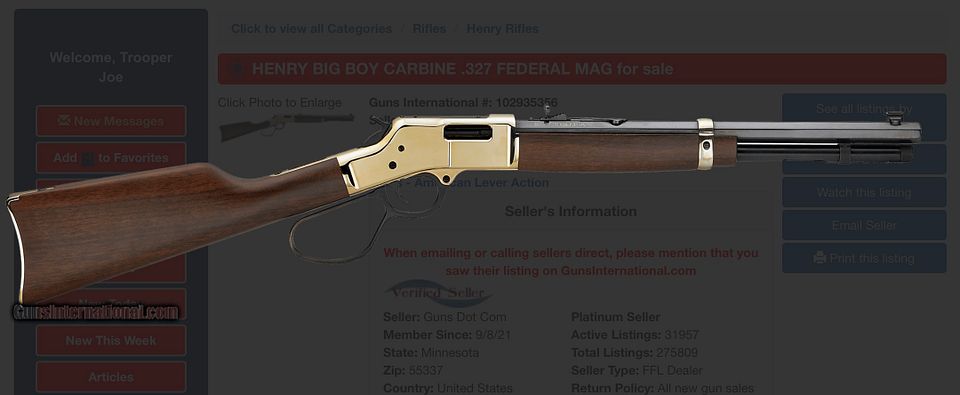

I do have a Henry Brass .327 carbine that is actually built on a Marlin 336 type of action and probably rated for a higher pressure threshold than the Marlin 1894. So if the consensus is to stay away from that conversion, I will keep the Marlin as is for .32 H&R Mag. I can pair the Henry up with my Ruger single seven which is in .327 Fed.

I thought about that myself at one point, but decided just to buy a Henry lever action already chambered in 327 FedMag.
https://www.henryusa.com/rifles/henry-big-boy-steel/
As soon as I can get a decent quantity of BRASS for it, I'll start working up a load...

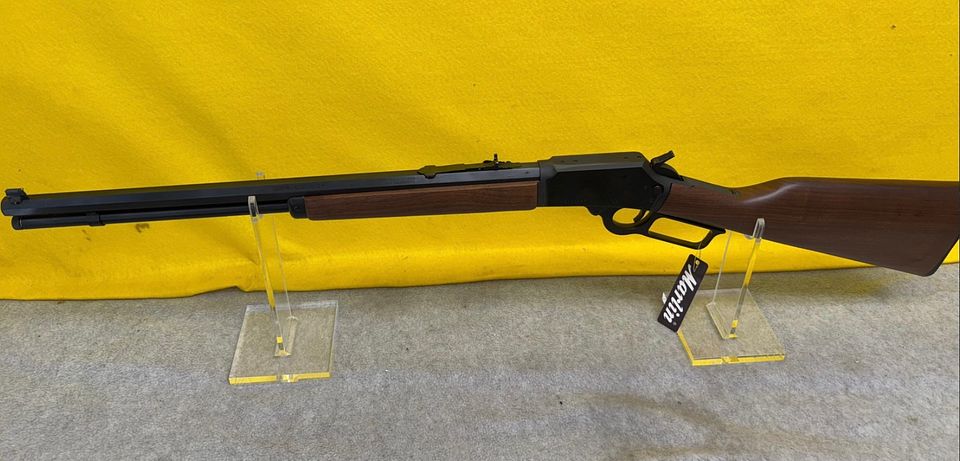

Re: Converting a Marlin 1894 .32 H&R Mag to ..327 Fed. Mag
Photos of mine.
